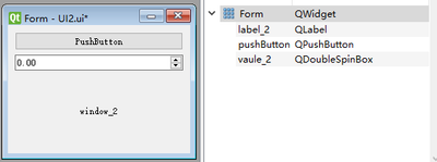

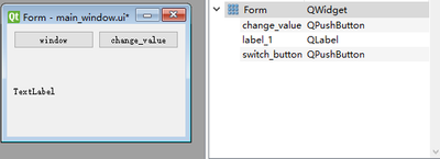

But, i have another question that when i want to get a value from window_2, the script report an error as below.
Traceback (most recent call last):
File "<string>", line 45, in Change_Value
AttributeError: 'PySide2.QtWidgets.QMainWindow' object has no attribute 'vaule_2'    ( 'vaule_2' is a DoubleSpinBox in window2)
Do you know how to salve the problem? Or,do you know how to exchange variables between the MainWindow and window_2?
Look forward to your reply,and thaks again.
Script:
from PySide2 import QtCore, QtGui, QtWidgets
import uiTools
form2, base2 = uiTools.loadUiType('UI2.ui')
class Window_2(form2, base2):
    def __init__(self, parent=None):
        super(Window_2, self).__init__(parent)
        parent.layout().addWidget(self)
        self.parent = parent
        self.setupUi(self)
        self.setupUserInterface()
    def setupUserInterface(self):
        """Setup and connect the plugins user interface"""
        self.pushButton.clicked.connect(self.change)
    def change(self):
        value = self.vaule_2.value()
        self.label_2.setText(str(value))
form, base = uiTools.loadUiType('main_window.ui')
class Main_Window(form, base):
        super(Main_Window, self).__init__(parent)
        self.setupUi(self)
        self.window_2 = QtWidgets.QMainWindow()
        self.switch_button.clicked.connect(self.creat_window_2)
        self.change_value.clicked.connect(self.Change_Value)
    def creat_window_2(self):
        self.window_2.setCentralWidget(Window_2(self.window_2))
        self.window_2.show()
    def Change_Value(self):
        value = self.window_2.vaule_2.value()
        self.label_1.setText(str(value))
main_window = Main_Window(VREDPluginWidget)
main window:
window_2:
Message 4 of 8
