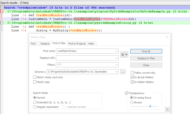

__daniel.lincoln__
Hi Christian,
I like to use Notepad++ Search, Find in Files... to locate example usages in the VRED example folder(s).
