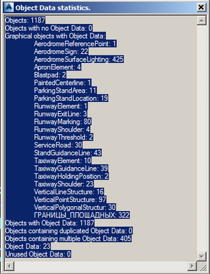

... Or, better, the statistics are more complete (approximately, as done for Object Data on the image):
* Objects: 1599
* Objects with no XData: 917
* Objects with XData: 682
* Registered Application Name: 130
* Registered Application Name: CIRCLE 3
* Registered Application Name: MYAPP 5 Multiple
* Registered Application Name: TEST 447
