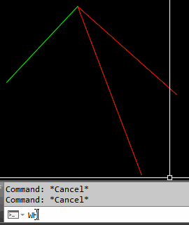

Hello friends, Good morning everyone.
How can I print a length between points P1 and P2 on the "KirisYaZiUzunluk" layer? text position = P1/P2
object snap : End point , intersection must be open.

I suggest a different approach:  Define a Dimension Style with both extension lines and both dimension lines suppressed, and with the prefix you want [and the text style and height, here using those of the Text in your sample drawing]:
Kent1Cooper_0-1628512212794.pngKent1Cooper_1-1628512285670.pngKent1Cooper_2-1628512328536.png
Then draw Aligned Dimensions.  All you need for a routine is this much:
(defun C:WHATEVER ()
  (command
    "_.layer" "_m" "KirisYaZiUzunluk" ""
    "_.dimstyle" "_restore" "YourStyleName"
    "_.dimaligned" pause pause "@"
  ); command
  (princ)
); defun
[Edit "YourStyleName" to whatever you call it.]
This has significant advantages over "loose" pieces of Text.  If you change the locations of the points, such as by STRETCHing or grip editing, everything adjusts automatically -- position, angle, numerical content, more-upright-readable text direction and side, etc.
