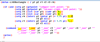

Can you please explain why here using "_.line" instead of "line" (marked yellow) also "_non"
1. and 0. after the list and inters what do the integers there (marked yellow)?.3

The underscore prefix makes it work in AutoCAD for any language.  The period prefix makes it use the native AutoCAD command, to avoid trouble if the command has been undefined and given a specialty new definition.  The numbers are Z coordinates in 3-coordinate XYZ point lists.

for polar the z coordinate should be 1 ?
Could be. And it's not a Z coordinate but a distance. While learning you can try to figure out why the actual value does not really matter unless it's zero.
Sorry -- the yellow-highlighted zeros are the Z coordinates.  The 1's are a distance, but in (inters) with the on-segment argument at the end being nil, i.e. not requiring the intersection to be on the segments between points but rather on the endless extension of those segments, then as @ВeekeeCZ pointed out, the distance doesn't matter -- a "virtual line" to intersect with the endless extension of can be of any length.
