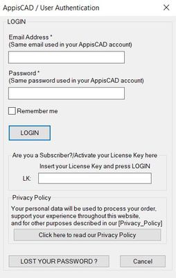

I have an AutoCAD Application which links the user to his account in the website via a DCL dialog as per the below figure
I am changing this DCl Login dialog to be used as Login (for already registered users) and Sing Up (for a new User).
In this case, I need to checkup the new user's email before sending the HTTP request to the server with User data (email password), I prefer to do that (email well-format checkup) in the AutoCAD session and not on the website PHP function.
