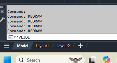

Moshe-A
update:
the issue comedown to this:
at VLIDE console key in this expression
OK, return "90", AutoCAD window filp on and the VLIDE pops on the command line, AutoCAD enters to an unstable state, vlide is stuck and can be close only from Task Manager.
Could not be i am the only one having this?!  (AutoCAD 2024 Vanila)
i have checked Autodesk Access and there are no updates waiting to download.

Moshe-A
@ВeekeeCZ
It only happen under vlide on R2024
On R2022 (on the same computer) it is working very well.
My machine: normal Laptop with windows 11
thank you
