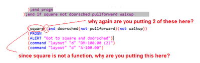

paullimapa
First of all, to test your combination, just do this at the Autocad command line.
Define square using something like (setq square 1).
Then test it at the command line by entering: (and square (not doorsched)(not pullforward)(not walkup))
If it returns T that means your combination worked because all the other variables have not been defined.
You can go one step further by defining one of the variables at the command line by entering: (setq walkup 1)
Then test it again at the command line by entering: (and square (not doorsched)(not pullforward)(not walkup))
If it returns nil then that confirms your combination is working.

its interesting that if I select square & I don't select walkup, & pullforward during the process it runs the code that its supposed to but I don't see the alert, but if I select pullforward or walkup I get the alert from the square no pullforward no walkup block of code but i get an error saying the function is not defined. This makes me think its not getting down there but the flow of the code is going through the other block of code. i know you told me to put it before the sequence but it seemed like it didn't run at all when i did that. By the way that was a typo before to answer your last post.
Message 18 of 35
paullimapa
you have to be very careful how you are entering your code...look at these errors:
Paul Li
IT Specialist
@The Office
Message 19 of 35
stanovb
I've seen other conditional statements like that with the "and" keyword .
That block of code seems to work. It at least it deletes & renames the right tabs. I was under the impression, the inside left parenthesis captures this:
and the outside parenthesis captures all of this:
Am I wrong about that? I tried to do this with nested if statements, but as the conditions became  a little more complicated I had problems with it. I guess I'm not sure how to write a statement that has one variable being true with an "and" clause & an "or" clause all working together. I tried to google it, but but couldn't find one that was exactly what I'm trying to do.
Message 20 of 35
paullimapa
you are wrong...try the changes I told you first before you reply.
Paul Li
IT Specialist
