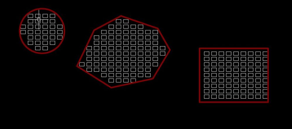

So for a particular task I need to trim and remove cells from a boundary with an action macro I can accomplish this fairly simply using the following procedure.
  1. Create unit cell (closed polylines)
  2. Copy unit cell
  3. Change layer to temporary layer
    1. Prevents deleting original unit cell or other completed boundaries
  4. Create a rectangular array from the cell
    1. Large enough to encompass the chosen boundary
  5. Move array to boundary location
  6. Explode rectangular array
  7. Run a boundary trim (outside) using boundary to remove only temporary layer
  8. Select open polylines to isolate partially trimmed cells
    1. Delete partially trimmed cells to ensure only complete cells are allowed
  9. Change objects back to original layer
  10. Repeat for other boundaries (sometimes upwards of 20)
So the process is fairly straightforward but time consuming-mostly because I am unable to select multiple boundaries to apply a boundary trim. If I could select multiple boundaries I would be able to skip the layer manipulations, copy/move operations, and multiple boundary trim/select/delete operations as well. The process is depicted visually below:
Cell overlay on boundaries (orange)Cell overlay on boundaries (orange)Boundary trim of cells to boundaryBoundary trim of cells to boundaryIncomplete cells removedIncomplete cells removed
I still need the objects to be countable (using a count by layer command or something similar) so I don't believe any sort of Hatch command will suit my needs but I am open to any and all suggestions to improve this task efficiency!
Thanks!

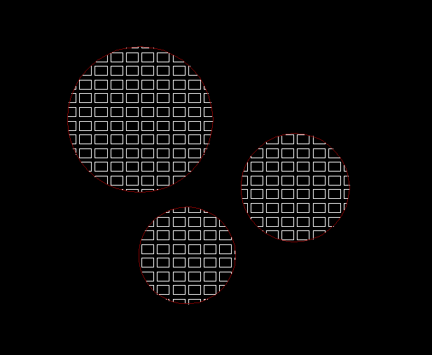

3wood
I think you can try SMARTSEL.
It does exactly what you want.
Given you have an exploded rectangle array contains of multiple polylines on Layer 0.
Then you have some boundary polylines on Layer 1 which is red:
Step 1. Use SMARTSEL to select whole rectangles inside all polylines on Layer 1:
Result:
Step2. Press "Esc" to deselect these rectangles. This selection is saved in a selection set of "previous".
Step3. Lock Layer 1.
Step4. Use ERASE to remove all other rectangles.
Remove "previous" selection from "all" selection.
Final result:
