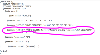

Any advice on the root cause? I have attempting using the Appload and CUI functions without any luck. Please help, I have 6 more units with the same problem

Thanks for the willingness to help! This community is great! Attached is the lisp and the error thread received in AutoCAD. I would love to know the results of the community testing this lisp with their respective system.

Thanks for the willingness to help. Attached is the lisp file and the error thread i received.
Your LISP fails because it is trying to insert a DWG file that is not found in your search paths.
You don't have a LISP problem, you have a missing DWG file problem (If I create a generic DWG with that name in a generic path applicable to my PC, your LISP finishes just fine)

Wow! Great response. I am impressed with your knowledge. I am fairly new to the coding of the lisp. Do you have a recommended solution for a shared office that everyone uses the same lisps and they are pulled from the server?
Message 10 of 15
pit4MSVJ
The path included in the lisp code is the actual source of the lisp file. Please excuse my limited knowledge.
I missed this reply from you: pathing in lisp needs two \\ and not just one \
... "X:\\filesfolder\\nextfolder\\nextsubfolder\\myfilename" ...

The mapping was incorrect and now fixed. Thanks to a great community full of helpful people!
