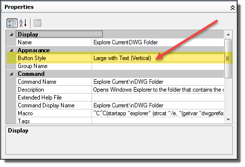

Good morning Guys, I'm adding some commands that were created for AutoCAD, and I would like to know how I keep the big ones and showing the command name the same as the example image.

While you are in the CUI, on the properties page of the item, do this.
Muito obrigado, consegui, sabe me dizer como alterar a imagem de um comando?

See purple frame.
Best choice is to take an image from other Icon -- just copy-paste it's name. Or yo can use a new one, 64x64 bmp, or png in new versions.
