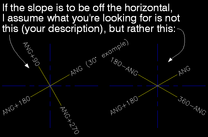

Message 10 of 10
Kent1Cooper
@Anonymous wrote:
after we add the option "Select Quadrant" to it.
I think we will have to modify it to get four cases:
Case 1: (setq ptL2 (polar ptL1 Ang         Len))
Case 2: (setq ptL2 (polar ptL1 Ang+90   Len))
Case 3: (setq ptL2 (polar ptL1 Ang+180 Len))
Case 4: (setq ptL2 (polar ptL1 Ang+270 Len))
But I don't know what "plaster" use to join these four "bricks" which I have...
If my assumption about what you mean by the slope going into the four quadrants is correct, (cond) is a good "mortar" [better word for it than "plaster"] for your "bricks." If the quadrant designation is stored in a 'quad' variable using the four quadrant numbers [as in my earlier Reply], then something like this should do it:
(setq ptL2
  (polar
    ptL1
    (cond
      ((= quad 1) ang)
      ((= quad 2) (- pi ang))
      ((= quad 3) (+ pi ang))
      ((= quad 4) (- (* pi 2) ang))
    ); cond
    Len
  ); polar
); setq
But that's not the only way -- here's another:
(setq ptL2
  (polar
    ptL1
    (nth (1- quad) '(ang (- pi ang) (+ pi ang) (- (* pi 2) ang)))
    Len
  ); polar
); setq
If, however, my assumption is incorrect, it can be simpler -- just multiply 90 degrees by one less than the 'quad' value, and add that product to the 'ang' variable:
(setq ptL2 (polar ptL1 (+ ang (* (/ pi 2) (1- quad))) Len))
