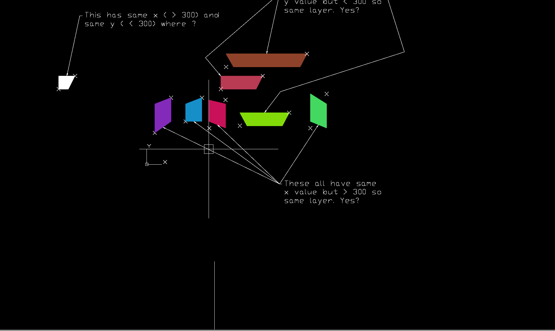

Good morning
I need some help, so I posted it.
For example
There are hatches.
1. x size = 300 or y size = 300
     I would like to select only hatches and move them to a new layer
2. If the x size is less than 300 and the y size is less than 300
I would like to select only the hatches and move them to a new layer
I'd like to ask you for some code that's available.

Message 21 of 27
anycganycgJ8A6A
pls see my attahed file
"That did not send the hatches to new layer" because you select wrong distance. If you're selecting X distance from the drawing, it must be horizontal. It's taking a DISTANCE, not a X-projection.

anycganycgJ8A6A
that is    4 same x size  = 317
so i  put  x = 317
Message 24 of 27
ВeekeeCZ
so i  put  x = 317
There are NOT. There are 4 objects with x = 317.0092.
Anyway, I added the precision, its set to 0.01, you may change the value.
