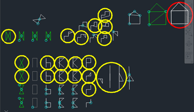

@marko_ribar,
A small polygon with no self-intersections or self overlaps started flying all over the screen. And the entire command window was taken up with messages about model regeneration.
For the large polygon, I interrupted the execution after a few minutes.
I think some wrong path has been chosen now. Basically.
It doesn't look like this is the way to get the speed and accuracy of the results right...
But they say “a negative result is also a result”.
-- Alexander, private person, pacifist, english only with translator 🙂 --

To make it more clear, I am guessing that to make LISP avoid false positive points like it throwed from last inspection your polyline (start/end vertex), I think that you shouldn't make zoom extents segments, but zoom window with just small tolerances around start/end vertices... (your last closing segment is drastically bigger than start/end segments, so when doing (ssget "_C" pt pt) I think that when zoom extents last closing segment, I think it selected both start and next segment (making false positive condition [ (> (sslength ss) 3) ]); this is also for ending point...) Here is my revised code, but notice that it works even more slower... It's not about making routine works fastest as possible, but making it works correct... (On normal polylines I am guessing that polylines should have at most 500 vertices - I'd apply @Kent1Cooper pldiet.lsp before starting this routine...)

@john.uhden,
I have circled in yellow where no self-intersections/self-overlaps/self-crossings are detected.
In red, no self-intersections/self-overlaps/self-touching are detected, and the Lines are obtained.
For polylines with coordinates in the millions, nothing is found.
But it works very fast!

I did it... All I did was used @john.uhden sub function which I altered...
It finds both self-intersection points and overlapping points...
I'll attach my newest picture and of course post *.lsp...
(defun c:selfinters ( / *error* selfsinfo unique selfinters cmd lw ti mult sp selfs )

Message 97 of 124
АлексЮстасу
@marko_ribar, @john.uhden,
Yes, all intersections/overlaps/touching are now located!
A little extra - the coincidence of the first and the last point does not need to be considered as a touching-intersection.
