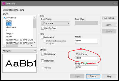

Just a friendly reminder for posterity, if like me you came to this thread having no success figuring out how to strip width factor from Mtext, don't forget to check whether it is set as a property of the text style (STYLE command).  StripMtext wouldn't set my text's width factor from 1.3 back to 1, and the in-editor right click menu item "Remove Character Formatting" wouldn't do it either.  Face palm when I realized there never was an override because the 1.3 width factor was defined in the text style.
