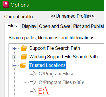

Also again very important is that since you've saved foo4.lsp in E:\
inorder for the code to load and run, you'll need to add this path to Trusted under AutoCAD's command OPTIONS>FILES>Trusted Locations:
This is all in the name of security so that some virus won't force code to load and run without your consent
