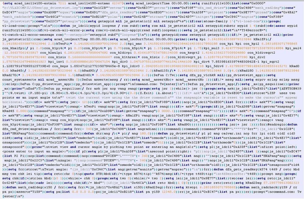

cl_aclayer_entviewe_2020_pp_dviewtwist-vlax.jpgYou program TW.Lsp you see new-version, you seeLisp but encrypted.
Main Hint is "You do not use multpile commands C:SNap, C:Tw , C:Q2, C:TWL
You use on command (C:TW) with
dfn_getx_readkey("[AEWT50H439]","(W.twist) (P.180-pi) (H.90+)(5.45+)(4.1pi/4)(3.3pi/4)(9.90=)(0.0)(X.Exit) (A.About)");
