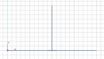

I'm sorry. I didn't explain it well enough.
For example, in the following figure, how can I select the three lines that pass through the point (100 0 0)?
line 0,0 110,0
line 90,0 200,0
line 100,0 100,100
Saitoib

You didn't read the text at link that I provided. There is actually a sample for similar case.
line 0,0 110,0
line 90,0 200,0
line 100,0 100,100
Command: (setq ss (ssget "c" '(100 0 0) '(100 0 0)))
<Selection set: 10>
Command: M
MOVE
Select objects: !ss
<Selection set: 10>
3 found

@hak_vz
Thank you very much.
I didn't know there was a way to do this.
I was able to solve the problem.
