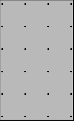

I am pretty new to lisp and have created a few programs for my work. One program I use creates holes within a rectangle by creating a boundary within an area then storing the len and wid and creating holes within. There are basically a bunch of cond statements that compare the hole distance and then creates more holes if the spacing is exceeded. I want to be able to use a selection set to select all of the rectangles at once and then apply the cond statements to each rectangle and create all the holes at once. I have the selection stored and all and the code extracts the values I need from the selection set so that I can create the pattern, however the issue I am having is that the cond. statements only apply to the last rectangle in the selection set (I believe that the selection set order is based on creation order if selected with a window). I think that every time a new len and wid of the rectangle is defined it overwrites the previous data and does not execute the conditional statements until the last entity is selected. I am wondering if anyone has any thoughts on how I could approach this problem? I know that I can create new variables within the code to match the number of entities within the selection set (I have a while loop that I am pretty sure makes sure the code is executed before the next selected entity is created). I could store a new version of len and wid for each selected entity say len1 and wid1 using read and set, but I don't know how to use the cond statement to compare a newly stored variable without literally copying and pasting all of the cond statements.
For example:
(cond ((and (> wid1 len1)(< len 8.5)(< wid 8.5)
(entmake (list (cons 0 "CIRCLE")(cons 10 holex3y1)(cons 40 0.25)(cons 62 2)))
(entmake (list (cons 0 "CIRCLE")(cons 10 holex3y2)(cons 40 0.25)(cons 62 2)))
Is it possible to compare (widx) and (lenx) x being the current entity in the selection set that I need the program to evaluate?
Any thoughts on this would be greatly appreciated (I can post example portions of the code as well but figured I'd get the issue fleshed out in writing before that). Thanks!

I am confused about the rules for the holes min Length min width size is ok. I drew a big rectang and it only did holes in corners, but your image shows multiple holes for same type of shape. What is the spacing rules of the multiple holes for the length and width ?
I think there will be a better method out there looking at a row & column approach. But that is a full rewrite I am sure an alternative is out there.

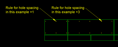

I revised the code so that it only does 1-1 through 3-3 possibilities for hole creation, the actual code I use for work goes up to 6-3 and 3-6 hole combinations. The rule spacing is once the hole distance exceeds 24in then it adds another hole. The code works the way I need now thanks to John's reply but I would be interested to examine other ways that I could have created this code.

Like devitg look at it from a row column solution and its way easier I am sure I have some where make holes given a length.
Ok its easy look at
total len - offset*2 from edge
divide the remainder by as you suggest 24 this is a number of extra holes but as a real so need to convert to a integer
divide the remainder by count this is the spacing for the holes
do again for height so you now have a row and column how many and spacing
just do a double repeat
all done
Please post a real dwg with the different hole patterns

Woon22
I will have to look into this method over the weekend as I am curious what other techniques I could use to create better programs. See the attached drawing with sized different parts, they all should be symmetrical unless the holes were moved to align vertically with the parts above.
