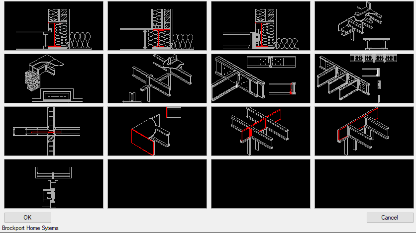

In the following image you can see the list of options on the left and the corresponding array of image_buttons on the right.
Just like your code, each image_button has a unique name, so after you invoke your DCL, use
(action_tile "image_1" "(do_something 1)") ;; where do_something is your function that takes one argument being the integer for the image ID.
(action_tile "image_2" "(do_something 2)") etc.
Now notice the red border around the selected image_button. You can do that with this tiny gift...

which relates the image_button picked to the list_box I call "slist" and the variable I call |slstyle
AND clears the red border around the previously highlighted image_button
AND draws a red border around the selected one.
All that because I wanted the user to have visual confirmation of his pick.
