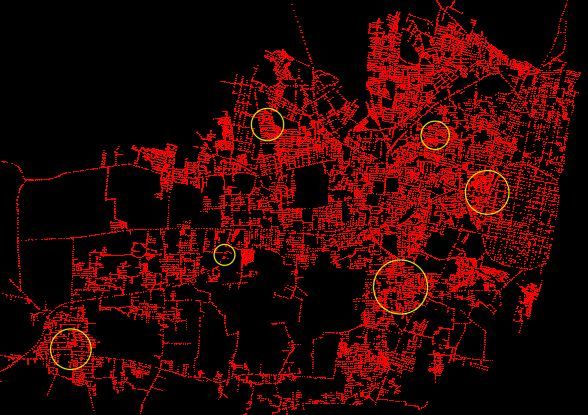

Dear Sir,
Please find attacahed drawing having lot of numbers. Marked some circles where alphabets also included in text. Some Texts have Prefixes and some have suffixes and some have both Prefixes and suffixes.Range Selection.JPG

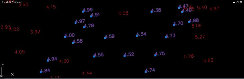

Message 16 of 34
Dear Sir,
Please forget about z elevations and min, max & avergae values of text.
The lisp code I have provided is for just editing.
The exact requirement is to selection only.
The lisp should select those numbers, which are in user input range (Suppose in between 4.5 to 5.0).
Here there is no matter of finding minimum, maximum and average value of text.
It's matter about only selection of text, which are having text value in between certain range of min and max values fed by user.
Please have a look on my attached image once, which autoselected the values between 4.5 to 5.0 and remaining to be unselected from user selection set. If you see in snapshot all selected values are in between 4.5 to 5.0 only.

Message 18 of 34
Dear Sir,
Thanks a lot, you saved lot of drafting time, Excellent.
