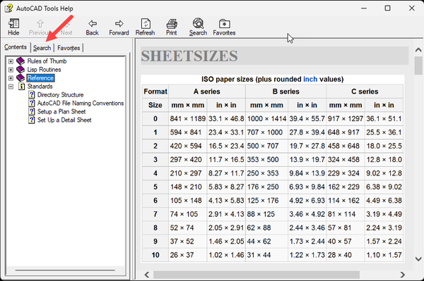

ronjonp
I put together an HTML help file (*.chm) about 15 years ago. It was nice because you could search for key words to look for routines. I'm sure there are much better ways to go about this these days but it still works pretty well for me 🙂
