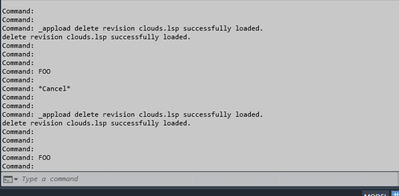

Hello Ronjonp,
It did not work, nothing happened, please see the image below, many thanks.
Message 8 of 36
ronjonp
@michaelZCXYL
Check your drawing ... the code does not report anything. You also have to modify this to match the name of your block you want to delete.
(2 . "NAMEOFYOURBLOCK")
Post a sample drawing too.

@michaelZCXYL wrote:
Hello Ronjonp,
Did your drawing contain revclouds that are LWPOLYINE objects types?
Did you edit the LISP to include the block name you wish to delete?

michaelZCXYL
I want to delete revision clouds, it has no name, thanks.

michaelZCXYL
Yes, it can delete current drawing revision clouds. Could you please advise me how to delete revision clouds on many drawings? thanks a lot.
