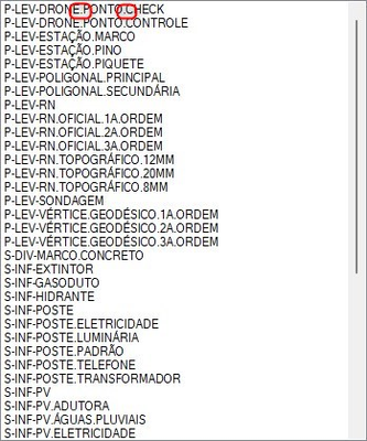

Hello, I'm trying to replace the all dots (".") by a "_" caractere in all blocks names using a LISP called RRENAME, like the image bellow:
I've tried to find in help file how to get this task done, but I can't find. Anyone can help me with the right expressions?

Without seeing "a LISP called RRENAME," it's hard to say....
EDIT:  I found >it<.  With limited investigation, it seems a  .  is a wildcard representing any character in patterns, and even looking at the instructions text file's "regular expression" link, I didn't find any reference to an escape character or other means to have that taken literally instead of as a wildcard.  I suspect some way of doing that is going to be necessary, but I'm not versed in such things.

Kent1Cooper
@lzedCB wrote:
.... I'm trying to replace the all dots (".") by a "_" caractere in all blocks names ....
For that particular task, this is enough [limited testing]:
(while
  (setq blk (tblnext "block" (not blk)))
  (setq bname (cdr (assoc 2 blk)))
  (if (and (not (assoc 1 blk)) (wcmatch bname "*`.*"))
    (command "_.rename" "block" bname (vl-string-translate "." "_" bname))
EDIT:  Corrected something, removed an unneeded element, and added prevention of trying to rename an Xref [just in case].
Kent Cooper, AIA
Message 8 of 9
lzedCB
Thanks! That was simple and effective in this task!
