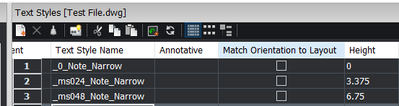

Maybe this also, a seperate step if you have to multiple layouts of a long pline.
Back to post if created by CIV3D I think there is a rotate to layout view for labels, which is what you want. Maybe check text style.
