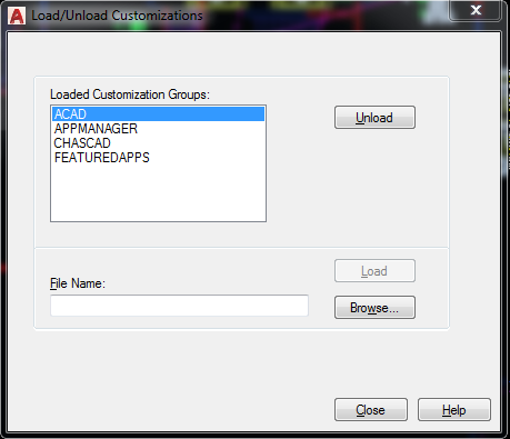

They are both loaded I attached pictures of the cuix menus pull down as well as an image our the loaded menus
Message 9 of 10
They are both loaded I attached an image our the loaded menus.

Okay... I think I know what the problem might be, but it is hard for me to verify. Since the SHORTCUTMENU values are the same between the two computers and set to a value of 0, the Mouse Buttons sections of the CUIx files control the behavior of the right-click button. Since the behavior is different, it seems like AutoCAD is locating two different versions of the ACAD.CUIx file which has the Mouse Buttons definitions in it as your CHASCAD.CUIx doesn't.
You can use the following statements, one at a time to see where AutoCAD is locating the two files and make sure they are truly the same files in the expected locations on the two computers:
(findfile "acad.cuix")
(findfile "chascad.cuix")
When the statements are pasted at the Command prompt, the locations in which the files are located by AutoCAD will be displayed in the Command window.
From what I can tell, the Click - Button 2 macro is set incorrectly in ACAD.CUIx for the computer that isn't displaying the custom right-click menu. However, that doesn't explain why POP0 is displaying in the Command window unless you are using some sort of custom MNL/LSP/ARX file that defines a POP0 command and possibly redefines the macro for AUX1, and AutoCAD can't locate that MNL/LSP/ARX program.  the other possibility seems that the Macro for Button 2 is wrong in a version of the ACAD.CUIx file that AutoCAD might be loading and when you are right-clicking AutoCAd is interpreting the macro wrong.
The Macro for Click - Button 2 from what I can tell should be the following which displays the GRIPS menu when a grip is active or your custom right-click menu when no command is active instead of the default Enter/Return:
$M=$(if,$(eq,$(substr,$(getvar,cmdnames),1,5),GRIP_),$P0=ACAD.GRIPS $P0=*,$P0=CHASCAD.POP0 $P0=*)
