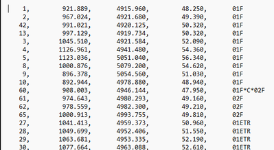

Dear all, don't make it complex. Think simple. I have a data on excel x y z point id & layer name. I just want to draw point in same layer as mention in excel . and also I want to draw text from excel. In "CAD tools" there was a option to provide layer name of text. But I did not find any lisp or script to draw point in predefine layer.
Point Name X CoordinateY CoordinateZ Coordinate Layer Name
DR491045.62532722.6640Design Road
DR4910502532725.1860Design Road
DR491054.42532727.8650Design Road
ER491059.82532732.130Existing Road
ER491064.92532735.8490Existing Road
ER491070.82532740.1570Existing Road
ER491076.42532744.3780Existing Road
BLD4910812532748.7390Builiding
BLD491085.22532754.8370Builiding
BLD491088.22532761.280Builiding
BLD491089.52532767.9010Builiding
BLD491088.92532774.6440Builiding

autoid374ceb4990
sdhara:
  Your original post indicated that you wanted to create a "topo survey".  The data in your last post has no Z values.  How do you expect to draw points and use them to create a contour map with no elevations?  Does your data just represent contour lines?
