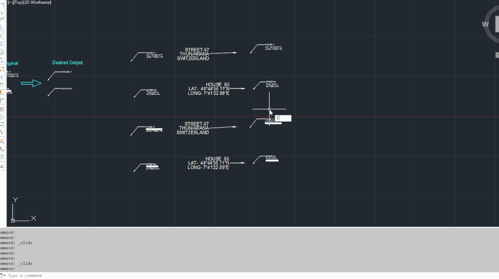

angelinabrown0123
I am looking for Lisp to remove the line from the Multileader, I tried to do a lot of searching on Google but I have not found any Lisp.
I have two types of mleaders, so I need two types of Lisp or you can add two types of options to Lisp.
First of all, I have to remove the first and the third line from the mleader.
And in the second mleader I have to delete all the lines except the first line.
If you help me to give lisp, i will be grateful to you

Message 3 of 8
angelinabrown0123
Thanks for the code, I tried testing your code on another drawing but it is not working on some mleader.
Please see the attached drawing.
Message 4 of 8

Message 5 of 8
angelinabrown0123
Now it is working properly, however I have to use both lisp because the new code is not removing the old mleader.
Still work, thank you very much 😀

Message 8 of 8
angelinabrown0123
At this time it is working on all types of mleaders, thanks for giving your valuable time, I will always be grateful to you. 😊
