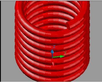

Clipboard01.jpgYou can simulate spline with sjn & cos.
You execute with C:Dan[enter]
Please you check freshui.zip
Message 7 of 17
leeminardi
The correlation of your comment to the topic of the thread is not clear.  The thread concerns spline creation not springs.  Can you clarify the significance of your post to the discussion?
