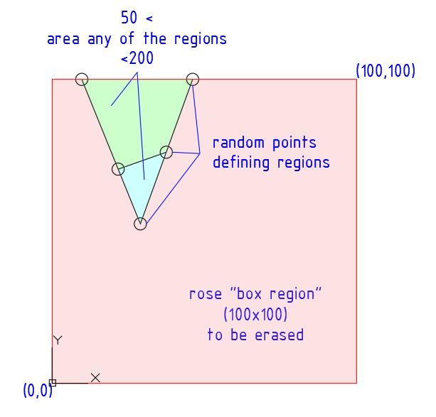

The picture shows a 100x100 box with 10 random lines in both horizontal and vertical directions.
All lines were broken with code from the breakall.lsp written by Charles Alan Butler and then transformed into regions with AutoCAD's "_region" command.
The area for any of the roughly 100 resulting regions must be within a range between 50 and 200 mm².
I need a function calculating all regions' areas, appending them to a list and first erasing the surrounding "100x100-box-region" always greater than 200 mm². The area list may be sorted, the min list area checked with >50 and the max list area with <200. If both conditions are met all random lines will be drawn, if not some kind of "while loop" will have to start again with a new set of random lines and finally print the number of loop calculations to the command line. Regions might be changed into polylines with e. g. "Region2Polyline" if that makes the area extraction easier.
Does anyone have an idea...

surfer96
Your routine works but it deletes the regions with areas outside the 50-200 area range.
Instead no region should be deleted. In case at  least one region in the selection set would for being <50 or > 200, all the region points should be randomly redrawn and the area-checking-loop restarted.
From the all-regions selection set we might need a list of all region-areas instead of a list of all regions. Then sort the areas-list and first delete its max value which will be the rose "box region". The min value will then have to be >50 and the max value of the remainig list (i.e. the second highest value of the initial list) <200.
If both conditions are met the loop has to be left, if not restart the loop to redraw all regions.
Here's some sample code for two random regions in a 100 x 100 box:

Tried rdlrep2.lsp which worked. If I got it, then "r_lst" is the list of region-areas, is that correct?
A minimum line length of e. g. 101 is not required , instead all line lenghts may be free, provided the lines span from box edge to box edge. However all randomly generated region-areas need to be within a RANGE from 50 to 200 mm² for ten lines in each direction after looping.
What about the following idea:
l_min 101.0 ; a minimum length of line is not required
;; set an initial region-area list
(setq r_list '(0 (* grid grid))
(while (< (car r_lst) 50 200 (last r_lst))
;whole random calculation of lines and regions
(setq r_lst (vl-sort r_lst '<)); sort region-area list from smallest (car r_lst) to largest (last r_lst)
); end while
Could that work?

dlanorh
); end while
Could that work?
Sorry, I missed your reply.
Yes r_lst is the list of region areas
I included l_min in case it was required at some point. The default min length is 100.0 so (setq l_min 100.0)
It is pointless putting the min and max areas into the list as they will always be the min and max, plus an area of 0.0 is the inverse of infinity and an impossibility for a region
(while (< (car r_lst) 50 200 (last r_lst)) ?? Not sure what you are trying to do? What are you testing? As written and coupled with the min and max above this will always be true, thus an infinite loop.
If you are trying to remove areas < 50 or >200 then it should go outside any loop
(setq r_lst (vl-remove-if-not '(lambda (x) (< 50.0 x 200.0)) r_lst))
If you ony want to save the area of regions where the area is >50 and <200 then
(if (< 50.0 r_area 200.0).........)
(setq r_lst (vl-sort r_lst '<)) Correct to sort the list min to max, but don't put sort routines inside loops, they only need to run once.
I am not one of the robots you're looking for

surfer96
Actually I don't want to delete any regions. Instead all regions should be recalculated in case the smallest region is smaller than 50 and the largest ist larger than 200.
What I meant was the whole random calculation of lines and regions could be "wrapped" in some kind of "while loop envelope" forcing all outcoming regions' areas to be within (50 - 200):
(while (or (< car r_lst 50) (> last r_lst 200))
"whole random calculation of lines and regions"
); end while
Message 13 of 20
dlanorh
Look at the image in your initial post. The probability of generating a region with an "out of scope" area (< x 50) (> x 200) using constricted random straight lines is infinitesimally large. The less lines you use the greater the chance a region will be too large. The more lines you use the chance of creating a region that is too small by intersection increases.
You would be better served generating random points, and attempting to contruct a triangular irregular network.

surfer96
Delaunay-, Voronoi- or similarly generated triangles from random points will not be "in line", but I'm definitely looking for a "linear" solution.
I tried to wrap your code with another while loop.
To simplify calculation the number of "inner random lines" in the "100-100-box" is set two one, ideally dividing it into 4 equal parts of 2500 mm² each. No region should be outside a 500-5000 mm² range.
Variables:
(setq bot_rg 500) ; bottom range
(setq top_rg 5000) ; top range
(setq r_lst '(0 (expt grid 2))) ; start region area list
(setq min_r_lst (car r_lst)) ; smallest in region area list
(setq max_r_lst (last r_lst)) ; largest in region area list
Loop:
(while (or (< min_r_lst bot_rg) (> max_r_lst top_rg))
(setq r_lst nil)
(while (not r_lst)
(while (> lcnt 0)
It works from time to time but prompts an error message in most cases.
Error : bad argument: AcDbCurve 97 occured
What's wrong with the loop?
