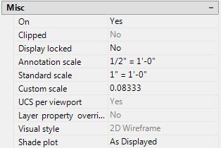

When I run the new code, it adds new annotative scales and I can't delete them. Now, I have multiple annotative scales of 1/2" = 1'-0" with percentages of 4.17% and 8.33%.
Message 7 of 16
Actually, it's renaming the pspace anno scale to the mspace anno scale.
Message 8 of 16
Is there anyway to have it perform "CANNOSCALE" after and have it reference the "Standard scale" as it shows in the properties for the viewport?
https://www.screencast.com/t/og8bybymLkB

For some reason it is still making me select the annotation scale in order for the view port and annotation scales to match.
Sorry for being difficult.
