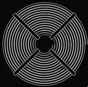

Alrighty Guys and Gals,
We here in the northern hemisphere have passed our winter solstice so the days are getting longer.  Summer is on its way, which seems to be an annual event.
That means it won't be long until your spouse says it's time to open the pool.  At my house that's usually April 30 or May 1.  While my wife will submerge herself immediately after the first vacuuming, I won't go in above my waist until the water temperature is at least 76°F, which in Monmouth County, New Jersey means about the middle of June.  So if this thing can raise my water temperature just 1° per day, then I might be able to take my first Nestea Plunge before Memorial Day.
I refuse to spend any money on a fuel powered heater, but I've had this idea for a long time of building a passive solar heater.  All you need is some poly pipe, a little plywood, and a Little Giant cover pump (which I already have).
Now materials and dimensions may vary from country to country, but my idea is to lay out a 100 foot coil of 1" poly  pipe on a half sheet of 3/8" to 1/2" plywood with gaps between orbits of about 1/4" to provide for drill holes and zip ties to attach the pipe to the plywood.  The idea is to provide one or more hinged legs on the rear of the assembly to direct the face at the proper horizontal and vertical angle to the sun as the season progresses.
Ergo, your challenge is to write an AutoLisp (including VLisp) function to create the coil design subject to the following rules:
1.  You must check the applicable pipe standards to determine the standard pipe O.D.  I'm talking about piping that would be used for a yard irrigation system.
2.  You may use any unit of measurement which is comfortable to you.
3.  You may not use an initial internal radius of curvature less than 10 inches at the centerline of the pipe lest it might create a kink in the pipe.
4.  You must try to use exactly 100 feet of pipe (or 30 meters or whatever) because couplings are not permitted except at each end for getting piping from the pump and back into the pool.  The outward limit is where the side of the end of the pipe intersects an edge of the plywood.
5.  You must provide only one (1) vertex per quadrant (NE, NW, SW, SE) which will happen to be where the holes will be drilled.  Also that will avoid placing holes near the edge of the plywood.  Your arced segments need not be exact because the radius is changing infinitely, but the result should appear to be exact.  Your poolyline should be drawn at a constant width equal to the pipe O.D.
6.  You may use trial and error to alter the gap size only slightly to have the outer terminus end as described in rule #4.  It would be better not to have any excess pipe that has to be trimmed off.
7.  Include in your drawing the actual dimensions used and the resulting length.  Mtext will be satisfactory because creating a table is just too much code.
Okay everybody, DIVE IN!!  Let's say that we want this submitted before the end of January, which will give you enough time after the Superball and March Madness to actually build your contraption before opening day.

Sea-Haven
My former boss had black poly on the roof, if set to pump to spa connected to pool it would raise water temp to way beyond acceptable and cold water from pool had to be added. A thermostat would be a good idea so excessive temp does not happen.
My code submission
Pretty sure will struggle to put 1/2 circle ends in 1" pipe as a reasonable small radius, you may be better with 1/2" use that for garden irrigation can be bent to a loop fairly easy, I would cross each loop so  1 radius on ends so could have simple tie point arrangement.

Kent1Cooper
@john.uhden wrote:
.... a 100 foot coil of 1" poly  pipe on a half sheet of 3/8" to 1/2" plywood with gaps between orbits of about 1/4" .....
3.  You may not use an initial internal radius of curvature less than 10 inches at the centerline of the pipe....
4.  You must try to use exactly 100 feet of pipe ....
5.  You must provide only one (1) vertex per quadrant .....
It looks like 'gaps...about 1/4" ' is going to have to be a little less than 1/4".  With my SPEQ commmand in Spirals.lsp, available >here<, I drew one at 1" Polyline width [though I didn't check actual OD of such piping] with an inner radius of 10", outermost radius of 23.5" so the outside edge gets to no more than 24" from the center, and spacing between turns of 1-1/4" for 1/4" gaps between 1" pipes.  I got this [the outer square is 4' x 4']:
It's a little less than 100' long [1136.7"].  If I force it to be 100' long with LENGTHEN's Total option, I get this:
which violates the sheet size limitation.
So unless I've missed the boat on the concept somehow, the gaps would need to be less than 1/4" to get the 100' in, and it may not even be possible if 1" poly pipe is a nominal size and the actual OD is larger, as with most kinds of piping I know about.

john.uhden
@Kent1Cooper,
I doubt that you have ever missed any boat.
So far, I have done my calcs using 1" pipe and 100' fits on a 4x4 sheet. I
don't have the code with me at work, but I think I did have to reduce the
gap to say 7/32". But now the problem is that the OD of nominal 1"
SDR-32.5 pipe is 1.315" so the ultimate solution may fall short of 100
feet. That's part of what this challenge is about. Shortening the pipe is
no big deal. I mean it's got to fit on the sheet, unless I use half of my
ping pong table. But my son likes to think he can beat my eldest
daughter, but he can't, and I like to observe, so I am not scrapping the
ping pong table, especially if she is my doubles partner.
Anyway, I guess it may boil down to what's the minimum gap that would be
suitable to provide a large enough hole for two zip ties to get through.
Oh, there ya go... the hole can be larger than the gap, so it's just a
matter of how thick (not wide) the zip ties are to fit between the pipes.
Okay, I found that a "Cable Tie, 8" Long, UL Rated, 50lb Tensile Strength,
PA66, Black, 1000/pkg" tie is only 0.05" thick, so a 1/8" gap would work.
I shouldn't have to be doing this for any of you. It's supposed to be your
design.
John F. Uhden

Kent1Cooper
@john.uhden wrote:
.... the OD of nominal 1" SDR-32.5 pipe is 1.315" ....
I realized one could get a little more length in with all curves at the min. 10" radius rather than gradually increasing.  And, a routine would have an easier time keeping track of the total length so far if all arc segments are therefore the same length.
But using your tube OD number, and with the gap reduced to about 3/16" [1-1/2" C-C between passes], starting with the 10" tube-center-line radius 3/4 of the way around in the middle and then sliding over for the next lap, I get this:
It's under 83' long [even another pass all the way around, which would exceed the 4' square, wouldn't quite get to 100'], but at least I can kind of imagine a way to get a routine to draw such a thing.
