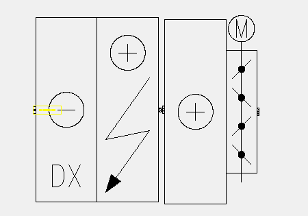

I am new to lisp program. I have to create symbol for AHU, with various different combination of sections. But the final output shall be one block diagram. I have created dynamic block wherein all the sections are present. We had created different types of AHU, the combinations become vast. So to make it simple, we would like to create command or menu, "AHU", on clicking, it should Pop Up TAB, wherein we could select the checkbox which sections we need and hit ok to generate block diagram. Is it possible? I have attached one Dynamic block.

Show us a couple of samples of what a Combination of block A,B, C, D, E,  or Combination of block A,B, C, E, looks like

Call me Patrick, I got that K. Peter, What I'm asking for is an actual drawing file of what you described as "the output shall be one Block object" .
  • Like how is it aligned?
  • is there a specific distance between the blocks?
  • will they be inside a box/frame?
  • Rotated 90 deg?
  • Does it come with a description?
  • What will be the eventual blocks names for the group? or having it Grouped is enough?
This Q&A will all be avoided or lessen at the least by providing a sample of the end result in CAD format , i.e the finish product.

  • Like how is it aligned? Horizontal to ground level.
  • is there a specific distance between the blocks? if  you are asking the size of each section consider 8mm x 22mm, if your asking about overall size of block then it will differ as per which combination we use, as indicated in word file.
  • will they be inside a box/frame?  Refer the Attachment 1, dynamic block after selecting anyone of the block, it should be seen similar, but for the example you will be creating it shall look like either of combinations shown in ms word file.
  • Rotated 90 deg? for now I am not interested in rotating or mirror, but if you can do it, it will be of more information for me.
  • one block without any description Good enough, name ahu.

I realized that the "AHU" block drawing attached at post#1 is different from the "AHU" block at post#3.
 We will call them by different name here as SB ( SETBLOCK ) and CB ( Comination ).
On some of the CBl , there is some kind of a filler between SBl's.
For the first Cblock , will that be
A | Filler | A | Filler | A | B | C | D  |
and the one on the right  as
| A | B | C | Filler | A | B | C | D | E |
A = a SB selected for spot A
B = a SB selected for spot B
Filler =  not a block included on the SB collection
Also need to account for the SB at the bottom ( Motorized Damper ). which is out of sequence.
It is indeed a daunting task from a programmers POV.

Hi Peter K , browsing your DWG , I notice that the blocks have different scale units . As to be easy to arrange, it shall be with the same SCALE UNITS and UNITS some are millimeters others inches . a simple way to what you want to , use the DESIGNCENTER or Ctrl+2 shor-tkey
Message 11 of 17
devitg
find attached a DWT , to use as blank dwg , and ahu-blocks-00 to use at designcenter all blocks are at same scale and units , milimeters Insert point at middle left
