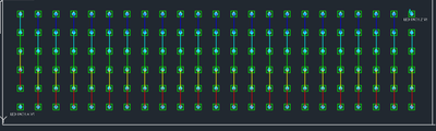

I've been working on a script to connect a series of LEDs to each other utilizing a BOTTOM and TOP point parameter, the code takes the correct TOP point and draws a polyline except it doesn't connect to the BOTTOM point of the block above it and I can't instantly see what I'm doing wrong

When you say "above" do you mean in the Y direction or the Z direction?

In the Y direction

Build a list of lists of the positions, mapped by X, sorted by Y, then connect the dots
Sorry lisp is above my pay grade, I hope this will illustrate the concept

@imegusta02  hi,
Attached ConnectStackedBlocks command to do want you after.
it start by asking [Select object(s)], select all your blocks (only 1 group of array). the block name does not
matter as long as it is dynamic and it has the TOP\BOTTOM dynamic properties.
The array must be rectangle align to WCS.
The blocks in a row must be aligned (same y) but small Y_FAZZ (default = 0.02) is allowed to consider them on the same row. the same rule is applied between 2 close blocks: Bottom and Top. if x value of both is equal or within X_FAZZ (default = 0.02), they consider one above other.
X_FAZZ and Y_FAZZ are 2 constant variables define at the start of the command. if you need a different fuzz, you are invite to reset them.
line 215 => (setq X_FAZZ 1e-2 Y_FAZZ 1e-2) ; const
1e-2 is equal to 0.02 😀

     (if (equal (car pt0) (car pt1) X_FAZZ)
      ent1 ; return
    ); lambda
   (cdr itm1)
  ); vl-some
 ); get_match_block_above
 (defun drawline (t0 t1)
  (entmake
    (list
     '(0 . "LINE")
      (cons 10 t0)
      (cons 11 t1)
 ); drawline
 (defun summarize ()
  (if (> notDynBlk 0)
   (prompt (strcat "\n" (itoa notDynBlk) " not dynamic block(s) skipped."))
  (if (> notMatched 0)
   (prompt (strcat "\n" (itoa notMatched) " block(s) skipped, has no match above."))
  (if (> notProp 0)
   (prompt (strcat "\n" (itoa notProp) " block(s) skipped, invalid TOP/BOTTOM properties."))
 ); summarize
 ; here start C:ConnectStackedBlocks
 (setq adoc (vla-get-activedocument (vlax-get-acad-object)))
 (vla-startUndoMark adoc)
 ; initialize global counters
 (foreach var (list 'notDynBlk 'notMatched 'notProp)
  (set var 0)
 (setq blocks (vla-get-blocks adoc))
 (if (setq ss (ssget (list '(0 . "insert"))))
  (progn
   (setq lst (vl-sort (build_data_list ss) (function (lambda (e0 e1) (< (car e0) (car e1))))))
   (setq i 0 item0 (nth i lst))
   (repeat (1- (vl-list-length lst)) ; loop main list
    (setq i (1+ i) item1 (nth i lst))
    (foreach ename0 (cdr item0) ; loop through bottom objects
     (if (setq ename1 (get_match_block_above ename0 item1)) ; get match block from above row
      (progn
       (setq AcDbBlkRef0 (vlax-ename->vla-object ename0))
       (setq AcDbBlkRef1 (vlax-ename->vla-object ename1))
       (if (and
	     (setq dx0 (LM:getdynpropvalue AcDbBlkRef0 "top x"))
	     (setq dy0 (LM:getdynpropvalue AcDbBlkRef0 "top y"))
	     (setq dx1 (LM:getdynpropvalue AcDbBlkRef1 "bottom x"))
	     (setq dy1 (LM:getdynpropvalue AcDbBlkRef1 "bottom y"))
	     (setq p0 (TransNested (list dx0 dy0 0.0) (list ename0) 2 1))
	     (setq p1 (list (+ (car p0) 0.1) (cadr p0)))
	     (setq p2 (TransNested (list dx1 dy1 0.0) (list ename1) 2 1))
	     (setq p3 (list (+ (car p2) 0.1) (cadr p2)))
        (progn
         (drawline p0 p2) ; main wire
	 (drawline p1 p3) ; paralle wire
	); progn
	; else
	(setq notProp (1+ notProp))
       ); if
       ; dispose memory
       (vlax-release-object AcDbBlkRef1)
       (vlax-release-object AcDbBlkRef0)
      ); progn
      ; else
      (setq notMatched (1+ notMatched))
     ); if
    ); foreach
    (setq item0 item1)
   ); repeat
  ); progn
 ); if
 (summarize)
 (vlax-release-object blocks) ; dispose memory
 (vla-endUndoMark adoc)
 (vlax-release-object adoc) ; dispose memory
 (princ)
); C:ConnectStackedBlocks

(defun c:LED ( / ssBlk sortedBlocks)
  (prompt "\nSelect LED Blocks to connect: ")
  (if (setq ssBlk (ssget '((0 . "INSERT") (2 . "LED_PATH_C_V2"))))
    (progn
      (ConnectBlocks
        (SortBlocks ssBlk)
      (prompt "\nLED Complete.")
    );progn
  ;else
    (prompt "\nNo blocks selected.")
  );if
  (princ)
(defun FilterList (lst filter / return)
  (foreach i lst
    (if (filter i)
      (setq return (cons i return))
    );if
  );foreach
  (reverse return)
);defun
(defun SortBlocks (ssBlk / cnt e pt oTop oBot blocks x stack return)
  (repeat (setq cnt (sslength ssBlk))
    (setq e (ssname ssBlk (setq cnt (1- cnt)))
          pt (cdr (assoc 10 (entget e)))
          oTop (list (getpropertyvalue e "AcDbDynBlockPropertyTOP X")
                     (getpropertyvalue e "AcDbDynBlockPropertyTOP Y"))
          oBot (list (getpropertyvalue e "AcDbDynBlockPropertyBOTTOM X")
                     (getpropertyvalue e "AcDbDynBlockPropertyBOTTOM Y"))
          blocks (cons (list e pt oTop oBot) blocks)
    );setq
  );repeat
  (setq blocks (vl-sort blocks '(lambda (x y) (< (cadadr x) (cadadr y))))
        blocks (vl-sort blocks '(lambda (x y) (< (caadr x) (caadr y))))
  );setq
  (while blocks
    (setq x (caadar blocks)
          stack (FilterList blocks (lambda (b) (equal x (caadr b) 0.01)))
          return (cons stack return)
    );setq
    (repeat (length stack) (setq blocks (cdr blocks)))
  );while
  (reverse return)
);defun
(defun ConnectBlocks (sb / Line lastBlk lastOffset lastPt offset pt)
  (defun Line (p1 p2)
    (entmakex (list (cons 0 "LINE") (cons 10 p1) (cons 11 p2)))
  (foreach stack sb
    (setq lastBlk (car stack))
    (foreach blk (cdr stack)
      (setq lastOffset (caddr lastBlk)
            lastPt (mapcar '+ (cadr lastBlk) lastOffset)
            offset (cadddr blk)
            pt (mapcar '+ (cadr blk) offset)
      );setq
      (Line lastPt pt)
      (Line (polar lastPt 0 0.1) (polar pt 0 0.1))
      (setq lastBlk blk lastOffset offset lastPt pt)
    );foreach
  );foreach
);defun

Oh wow thanks that's exactly what I was trying to achieve. One quick question tho, what would I have to do/change if I want to connect more points together something like the image I provided, I assume I'd have to make more point parameters in the block itself but how would this be added in the code you provided? Thanks in advance
Message 11 of 17
imegusta02
thanks but this is to connect the insertion points to one another which isn't really what I'm looking for.
Message 12 of 17
CodeDing
@imegusta02 ,
If you zoom in to my created lines, you see that it already creates 2 of them like in your example drawing. That is accomplished with these two lines of code:
(Line lastPt pt)
You can add more lines by using more Line/polar functions, if you understand how those work.
Best,
~DD
Message 13 of 17
imegusta02
I'm not that familiar with them to be honest but if I understand it correctly it draws a line from lastPT to pt and then offsets the next line the required 0.1 for both points, so if I want to do it for the other connections I just have to measure the distance and use those for the offset values right?
Message 14 of 17
CodeDing
Correct,
The (polar ...) function creates a point by taking:
- a point [pt], as a starting location [in our case, lastPt or pt]
- an angle [ang], in radians, as a direction to travel [i used 0, because that is directly to the right (pi would be to the left)]
- a distance [dist], as the distance to travel [i used 0.1 in my code]
so as long as you use that info, you can create a new line anywhere you wish.
Best,
~DD

@imegusta02  hi,
Modified mine to meet your last requests.
Attached the full lisp + your dwg with 2 wires as sample.
what i did is changed the properties point name to BOOTOM1\TOP1 and add another called it BOTTOM4\TOP4
Now look in middle code (lines 28-29)
