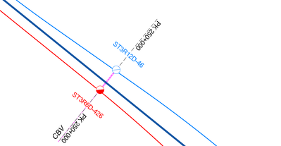

Hello guys!, this is my first post ever.
I've a LISP that takes the Length of the Polyline and place it as value on a block attribute.
But the length format is; 59500 (example) and I want it to be 59+500,...59+459 and not 59459.... etc, depending on the length of the polyline selected.
I'll also post the Rutine in case someone else finds it useful
PD: I'll also wanted to add PK XXXX(length of the polyline) but I not able to be able to add it,
Any help will be highly appreciated!.

Kent1Cooper
Replace this much:
(setq leng (rtos
  (vlax-get-property obj "Length"
  2
  0 ; <--precison 3 decimals
with this:
(setq
  meas (rtos (vlax-get-property obj "Length") 2 0)
  leng
    (strcat
      "PK "
      (substr meas 1 (- (strlen meas) 3))
      (substr meas (- (strlen meas) 2))
    ); strcat & leng
); setq
EDIT:  That assumes that you want only the last 3 digits separated with a +.  If the measurement ever came to more than 6 digits, the above would change "1234567" to "PK 1234+567".  If you want groups of 3 separated, to have that as "PK 1+234+567" more code would be required.

The question is what if the value is less than 1000. Whether it should be +500 or 0+500. The lower code does the latter.
(vl-load-com)
(defun c:LTA ( / *error* dnz e l a)
  (defun *error* (errmsg)
    (if (not (wcmatch errmsg "Function cancelled,quit / exit abort,console break,end"))
      (princ (strcat "\nError: " errmsg)))
    (if dzn (setvar 'dimzin dzn))
    (princ))
  (setq dzn (getvar 'dimzin))
  (setvar 'dimzin 0)
  (while (setq e (car (entsel "\nSelect polyline: ")))
    (if (and (or (not (vl-catch-all-error-p (setq l (vl-catch-all-apply 'getpropertyvalue (list e "Length")))))
		 (prompt "\nError: Wrong selection, need a polyline. Try again!"))
	     (setq a (car (nentsel "\nPick attribute: ")))
	     (setq a (entget a))
      (vl-catch-all-apply 'setpropertyvalue (list (cdr (assoc 330 a))
						  (cdr (assoc 2 a))
						  (strcat "PK = " (vl-string-translate "." "+" (rtos (/ l 1000) 2 3)))))))
  (princ)
Also, if you want to try Kent's suggestion, replace both what with meas in his code.

I tried Kent suggestion but I'm getting it didn't work by replacing the code and adding the variables at the top.
Yours works fine!, But I can't quite figure out how to add the "PK = " at the beginning of the value of the polyline length on the attribute
