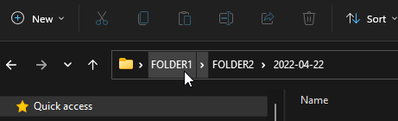

ronjonp
You could also do this easily in Windows Explorer. It's one more click though. 😃
