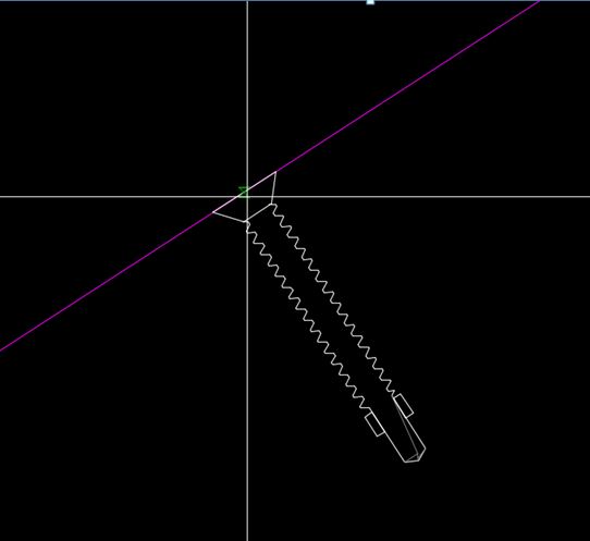

@Anonymous Here's an alternate way of doing it. Instead of using a point parameter for the Lookup Input, I used a linear stretch for the length/top view and a flip for the threads. The visibility state will change as you stretch the grip, and threads turn on/off when you use the flip. It's the same as using the pull down menus (but better functionality in my opinion) so you can suppress the Lookup grips if you desire.
For screws and such, I would suggest using an Alignment Parameter at 0,0 so it aligns to an object upon insertion (see attached pic). I use this in lieu of a rotation
See attached block; hope this helps
EDIT: I just read Libbya post about linear parameters vs point parameters, it was buried in the post and I skimmed over it
Using an array would allow you to create more options, such as changing the screw head type or diameter, since you wouldn't need visibility states for the length
