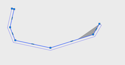

Message 46 of 63
kibitotato
unexpected result into autocad 2024 spanish... don´t know why.
Message 47 of 63
Kent1Cooper
We can't diagnose that from an image.  Post a .DWG file in which this happens, with before and after.  And which of the several routines are you using?
Kent Cooper, AIA
Message 48 of 63
kibitotato
I think that sometimes fails the join and close operation. Don´t know why. Sometimes works sometimes not...
Message 49 of 63
Kent1Cooper
That drawing file doesn't really tell us much -- it needs to show the "before" conditions.  What did you start with?
In any case, making some assumptions about which part of those was the initial object, it seems some things are not Joining, but I have no idea why not.

Yes.  Unfortunately, the command succeeds in it for me [Acad2020 here -- I can try with a later version elsewhere later].  That makes it pretty impossible to trouble-shoot.  Since the problem seems to be in the joining, it could be that the JOIN functionality has been altered in some more recent version, so that these lines
            (initcommandversion); [to accept initial multiple selection]
            (command "_.join" toJoin "")
might need to be done differently.

I just opened the version as posted at Message 48, and I see that HPSCALE setting has not been changed.  I think that must mean you changed the scale of the patterns in the sample drawing after using the command.  Losing the possibility of mis-editing leaves me at a loss for an explanation, but it seems to be JOIN-related, since your red boundaries where it goes wrong are not the single Polylines that they ought to be, and that they become when I try it.

Sometimes works... I think that i get the same proble using OCH and join opperation...
Message 58 of 63
Kent1Cooper
@kibitotato wrote:
SELECTING multiple objects to join at once: DOESN´T WORK FOR ME
EDIT 2
I was wondering whether it might be a version difference, but at least in Help, the description and listed prompt and options for the JOIN command are identical in 2020 and 2024 [and 2025, for that matter].
I wonder whether a re-installation....
Kent Cooper, AIA
Message 59 of 63
kibitotato
restored the defaults into autocad... It works...
Sorry for bothering you... Thank you so much.
