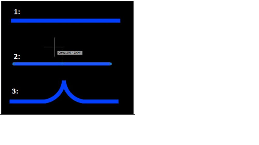

I need to separate polyline by point on it and add a curve from a polyline to this point like it drawn on picture with option to reverse this curve and join polyline after all..
Is it possible to do it programmatically (via lisp function)?
Any help or suggestions will be very appreciated

Would this always be in a single-line-segment  Polyline as in the picture [which shouldn't be too difficult], or would it sometimes be in segment within a longer Polyline [much more complicated, I think]?

Try this lisp. Tested in WCS and UCS, but not for 3D rotated polylines; new vertex only on straight segments, IF there is enough space to draw the arcs. Also, feel free to add your favorite error trap.

Wow   phanaem  !
It's genius! I thought about how to reverse curves depends of point destination and how to join segments after transforming, but here all my questions find appropriative answer
Thank you Stefan M  for your master and brief solution
