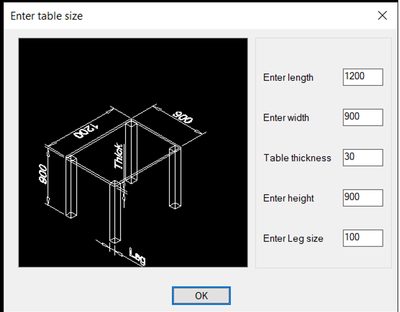

Sea-Haven
Your welcome to modify this, very close.
; Getvals multi allows multiple line inputs with an image must be a slide image
; By Alan H Oct 2019
; code examples
; Example Code to use sldie name is furntable
; (if (not AH:getvalsimg)(load "Multi Getvals img.lsp"))
; (setq ans (AH:getvalsimg "D:\\Acadtemp\\furntable" 40 (list "Enter table size" "Enter length" 5 4 "1200" "Enter width" 5 4 "900" "Table thickness" 5 4 "30" "Enter height" 5 4 "900" "Enter Leg size" 5 4 "100")))

 your welcome to modify this to suit.
(setq len (atof (nth 0 ans))
wid  (atof (nth 1 ans))
thick (atof (nth 2 ans))
Ht (atof (nth 3 ans))
leg (atof (nth 4 ans))
