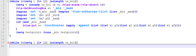

hak_vz
@Automohan  Code visibility can sometimes be a problem.
In editor Notepad++ and many other you have option to temporarily close block of code
In attached picture whole WHILE block is folder to single line and can be collapsed when needed.
Check link for further explanation.
Miljenko Hatlak
