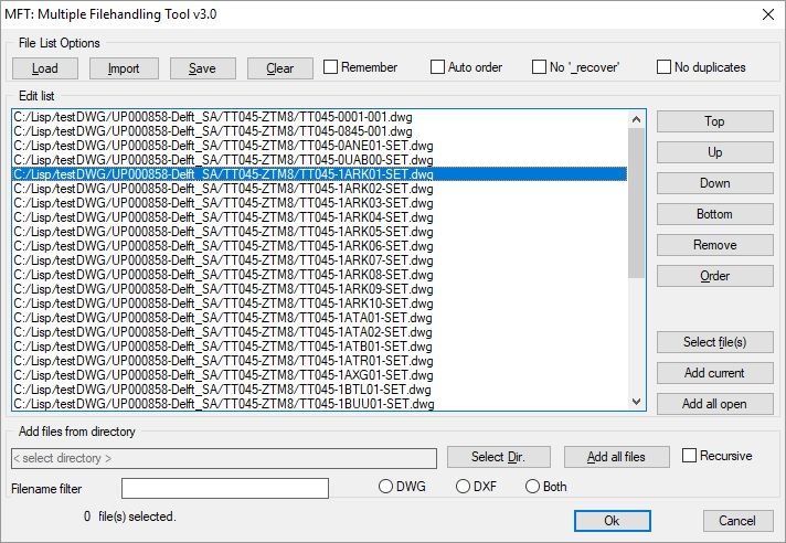

Hi guys,
Attached you will find my MFT.lsp, which stands for "Multiple Filehandling Tool"
It allows to select files (*.dwg / *.dxf), in pretty much any way thinkable.
& to suply a lisp (*.lsp) to be loaded and/or commands to be executed, on each file.
MFT Main dialogMFT Main dialog
The idea is to share this with anybody who needs to process multiple DWG's (or DXF's).
& Its supposed to work on any version of ACAD, in combination with DOSlib.
...but I can only test it on 2014 (64bit) & 2015 (64bit)
...and the code can surely be improved in many ways. (which comes with a ton of comments)
& thats what I need you guys for.
Any version you can test it on, any bug you find, any improvement you can make, any suggestion you have: Bring it on! (& make this a tool everybody wants Smiley Wink)
Note: the command part is an addition I stuck in recently and still need to work out a bit.
The idea was to create a script & load that with each drawing, but that doesn't work.
So I changed it to an (eval ...), which works with the example you see inside the screenshot above, but I didn't yet test it with multiple lines and/or script like commands (e.g: "Zoom e" instead of "(command "zoom" "e")")
I might just reduce the option to a single line of code, if it turns out to difficult to allow for more. (& if you put 'garbage' in, you will get garbage out during processing, so be carefull with that option)
It comes with a ini file & dcl for the main dialog.
I've used "C:/Lisp/MFT/" to put the files in & it uses a subdirectory "DATA" for saving a list of files and a .scr file to hold the commands. It doesn't check or create it, so if not there, nothing will be saved/loaded for those two files/options.
You should be able to put it anywhere, just edit the path inside the .lsp INIT section
   (setq MFT_files "c:/Lisp/MFT/")
Where you might also set a path to find DOSlib. (It will try to find it within support path first)
   (setq DLpath "C:/Lisp/DOSLIB/")

roland.r71
Have a nice vacation then.
I'll see if I can get that list_box up and running for the main dialog in the mean-time.
Having the list visible (& editable) right there has always been my wish, but 11-14 years ago I couldn't get it done. (I created the first version back in 2004. version 2.1 comes from 2007 (& a minor update for acad2011 back in 2010 to version 2.2))
Now I (think I) can.
Just reworked my checking procedure too. That part of code was 14 years old & always worked perfectly, but it could definately use an update, code & speed wise. Now it should be a lot faster as I don't just always check the entire list anymore, unless I have to. Still need to add some new code for the dialog options, so it will for example only check for duplicates when turned on, instead of just performing a complete check. This should increase its performance with huge lists (1000 or more) significantly.

roland.r71
Thnx!
That's a lot of (welcome) info.
I just made a few rigorous changes to the dialog. Cutting it (back) into two parts for one.
The upper "settings" part & the lower "fileselection" part are separate (again). This to allow for wrapping the fileselection into any lisp function. Same for the "processing" part.
The biggest change: The file selection part now has the filelist visible and editable.
It used to be "hidden" behind the "edit" button.
So, I'll have to see what exactly you did there and 'copy' that to the new version.
edit:
Preview of the new dialog (for file selection) - note: this is from a separate test, so not all is set.
Message 45 of 45
roland.r71
I finnished up my work on the dialogs (using @scot-65's work) & splitting up the functions. With previous versions the file selection & processing (script generator, back then) could be called separately. I initially chose not to do so for this version. But it is way more versatile if they are.
