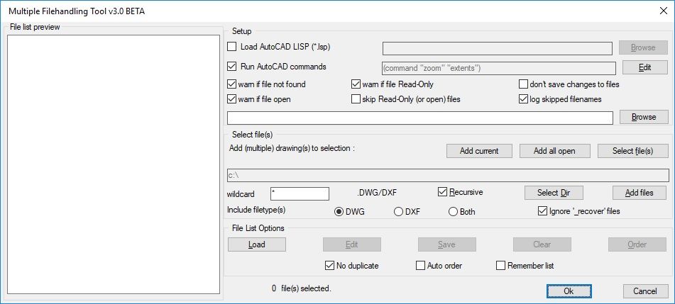

Hi guys,
Attached you will find my MFT.lsp, which stands for "Multiple Filehandling Tool"
It allows to select files (*.dwg / *.dxf), in pretty much any way thinkable.
& to suply a lisp (*.lsp) to be loaded and/or commands to be executed, on each file.
MFT Main dialogMFT Main dialog
The idea is to share this with anybody who needs to process multiple DWG's (or DXF's).
& Its supposed to work on any version of ACAD, in combination with DOSlib.
...but I can only test it on 2014 (64bit) & 2015 (64bit)
...and the code can surely be improved in many ways. (which comes with a ton of comments)
& thats what I need you guys for.
Any version you can test it on, any bug you find, any improvement you can make, any suggestion you have: Bring it on! (& make this a tool everybody wants Smiley Wink)
Note: the command part is an addition I stuck in recently and still need to work out a bit.
The idea was to create a script & load that with each drawing, but that doesn't work.
So I changed it to an (eval ...), which works with the example you see inside the screenshot above, but I didn't yet test it with multiple lines and/or script like commands (e.g: "Zoom e" instead of "(command "zoom" "e")")
I might just reduce the option to a single line of code, if it turns out to difficult to allow for more. (& if you put 'garbage' in, you will get garbage out during processing, so be carefull with that option)
It comes with a ini file & dcl for the main dialog.
I've used "C:/Lisp/MFT/" to put the files in & it uses a subdirectory "DATA" for saving a list of files and a .scr file to hold the commands. It doesn't check or create it, so if not there, nothing will be saved/loaded for those two files/options.
You should be able to put it anywhere, just edit the path inside the .lsp INIT section
   (setq MFT_files "c:/Lisp/MFT/")
Where you might also set a path to find DOSlib. (It will try to find it within support path first)
   (setq DLpath "C:/Lisp/DOSLIB/")

That's quite an undertaking.  Of course you realize that makes you an undertaker.  😕
Just looking at the DCL, I'm wondering (i.e writing without testing) if the commands could be constructed much as a script is, except that at run time you convert them.  This method would require each command string to be separated by semicolons where a keyboard Enter or Space takes place.
For example:
Command: (setq str "layer;m;ABC;C;2;;lt;hidden;;")
Command: (setq lst (@str2list str ";"))
("layer" "m" "ABC" "C" "2" "" "lt" "hidden" "" "")
Command: (eval (apply 'command lst))
Of course that method treats everything as a string, whereas some command strings might require numeric entries.
But maybe the format could require that numeric strings be prefixed with the # character and that the @str2list function converts those to 'REALs or 'INTS depending on the presence of a decimal point, or maybe by the distof function.  Plus it would have to treat contents within parentheses literally, I guess, as one string.  But that's what we're here for, right?  I'll be glad to handle that part.
BTW, why isn't the drawing list in a list_box?  The length of the list can exceed its height.
Mmmm. this Svedka clementine vodka tastes really good.  😕
John F. Uhden

There was no list_box for a few reasons, one being the size of the main dialog, another being about editing the list. But I might as wel put one in there. Just found some LM: stuff that might even help to make it functional & that would make the current [edit] button under "File List Options" obsolete, but that would mean even more buttons on the main dialog. (which could be better I think, but I'm out of inspiration for the layout)
I did a quick hack to see how it could look (but apparently I can't pass the MFT_filelist as it is, so its empty for the moment):

John F. Uhden
Message 18 of 45
cadffm
Thats not a script and not a lisp, thats a menumacro.
You have to re-write that in script syntax.
-Purge
All
No
Or lisp (command "-purge" "all" "*" "no)
And check the dir button, also recursive button
I didn't test the recursive and i don't look into the code, but i think...
Sebastian
Message 19 of 45
john.uhden
Thank you, Sebastian, for providing that distinction.
As it is right now, my mind is sort of hung up on creating lisp constructs, which may well be the wrong direction, but it's fun trying.
John F. Uhden
Message 20 of 45
cadffm
Ha,
I answered to mrushcadtech only, and now i see that you working on a translation function, funny.
(i have no time for this thread now, so i didn't read all)
I like both, menumacro converting to (command..),
also the real Script syntax and the option save the content as *.scr and to select a *.scr file
You can save your list as *.scr which works also without having/starting MFT.
In newer version (than yours) you can also start other script files from a script (command SCRIPTCALL)
So it isn't a problem to create a *.scr with lisp statements, normal commands and options (script syntax) and start other script.
But ok, thats all isn't really needed if you can save/restore the mft-settings and file list in another kind and place. Just another "stupid" way to save mft-jobs.
Just4fun
Sebastian
