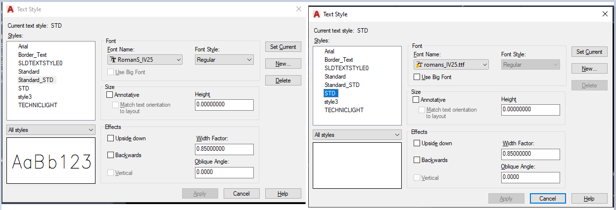

I could use a little help.
I have a client that wants us to switch out all the fonts on drawings to be Ture type font to make pdf's searchable. So I wrote a lisp routing changes ‘romans.shx’ to ‘romans_IV25.ttf.’
I am not getting any error with lisp, but it’s not working right.  So have two styles, one set by code and one set by the “Text Style” form. When I do an entget they both look the same…
Set by form:
style:((-1 . <Entity name: 208f1283d00>) (0 . STYLE) (330 . <Entity name: 208f0bcd830>) (5 . 3040) (100 .
AcDbSymbolTableRecord) (100 . AcDbTextStyleTableRecord) (2 . Standard_STD) (70 . 0) (40 . 0.0) (41 . 0.85) (50 . 0.0) (71 . 0) (42 . 0.2) (3 . romans_IV25.ttf) (4 . ))
Set by code:
style:((-1 . <Entity name: 208f0d51b30>) (0 . STYLE) (330 . <Entity name: 208f0bcd830>) (5 . 3A63) (100 . AcDbSymbolTableRecord) (100 . AcDbTextStyleTableRecord) (2 . STD) (70 . 0) (40 . 0.0) (41 . 0.85) (50 . 0.0) (71 . 0) (42 . 0.125) (3 . romans_IV25.ttf) (4 . ))
However when I open the ‘Text Style’ form, the one set by code is showing as missing font, even thought it's set to exact same file name.
ScreeenCapture....any help would be grateful.

		(entmod (subst (cons 3 f) (assoc 3 st) st))
now it's inserting this...
style:((-1 . <Entity name: 208efbca460>) (0 . STYLE) (330 . <Entity name: 208f0bcd830>) (5 . DB8E) (100 . AcDbSymbolTableRecord) (100 . AcDbTextStyleTableRecord) (2 . Border_Text) (70 . 0) (40 . 0.0) (41 . 0.9) (50 . 0.0) (71 . 0) (42 . 0.09375) (3 . C:\windows\Fonts\romans_IV25.ttf) (4 . ))
...and still shows as missing font, even thought that file exist.

This worked for me to change the Romans.shx styles to RomanS_IV25.ttf
(if (findfile (setq f (strcat (getenv "windir") "\\Fonts\\Romans_IV25.ttf")))
  (progn (vlax-for s (vla-get-textstyles (setq doc (vla-get-activedocument (vlax-get-acad-object))))
	   (and (wcmatch (strcase (vla-get-fontfile s)) "*ROMANS*SHX*") (vla-put-fontfile s f))
	   ;; (vla-put-width s 1.0)
	   ;; RJP » 2020-04-29
	   ;; (vla-setfont s "Arial" :vlax-false :vlax-false 0 34)
	 (vla-regen doc acallviewports)
Message 9 of 10

I rewrote the code more visual lisp commands, a little of pain because I just don't know it very well. But ended working just fine....
