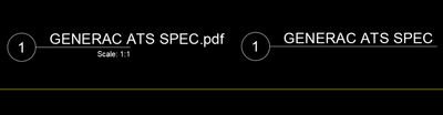

fabi_rm94
Do you have any idea why the lisp tends to work the first time you try it but afterwards it will just create a copy of the ctab and not bring in the pdfs? It's very fragile at the moment and I don't know why. Im trying to troubleshoot it but nothing is helping
Message 8 of 23
paullimapa
That is odd. Not sure why that’s the case.

Message 10 of 23
fabi_rm94
see comment below
Message 11 of 23
fabi_rm94
I've been troubleshooting so I've been trying different versions of the lisp routine so I can figure out what works without having to undo all the time.
Its currently working so Im just trying to go with what I have. The last request I have is that I'm able to delete the ".pdf" part of the view name that's coming in with the pdf name, delete the scale, and make the leading line under the title name as long as the name (if thats not possible setting to a distance of 3" would be ok)

I figured out when it doesn't work. It doesn't work when R-601 is the last page in the template. When I run it then, R-602 is created and the lisp stops. If R-602 already exists, then it runs fine. Ideally I would want it to create R-602 and then keep going with the rest of the lisp but that's not what seems to be happening.

Message 14 of 23
fabi_rm94
The only thing that still doesnt work is the R-601 page part, and I think I need to clarify myself. BEFORE I use the lisp, the last page will be R-601 on the template. I need the lisp to run the command and place the PDFs chosen STARTING on R-601.
Currently, the lisp is creating a copy of R-601, changing its name to R-602, and THEN placing the selected pdfs on R-602. I need that process to start on the very first page (R-601), and then, if needed, create further copies of R pages that count up (R-602, R-603, R-604, etc). I do not need the LISP to move R-601 to the end of the created R pages.
I do believe the fix is a very quick and easy one, I just can't quite figure out how to fix it or what to change that part of the code to.
Thanks so much!
Message 15 of 23
paullimapa
Ok, the modify lisp should start attaching pdfs on layout R-601...give this a try.

fabi_rm94
I tried putting the above code in a couple of different places before the "vla-put-textstring attribute" part and it never worked. Not sure what's going on. Attached is the latest version of the code I have. If you could help me figure this last bit out, I'd be eternally grateful
Message 19 of 23
paullimapa
I made the changes basically in this section as I mentioned.
I did not test the entire routine. I'll leave that up to you.
Paul Li
IT Specialist
@The Office
Message 20 of 23
fabi_rm94
Unfortunately, the detail title block is still coming in with the 285 ahead of it. I've tried various locations for that snippet of the code and general troubleshooting for it and nothing has worked. Is there something missing in that part of the code?
