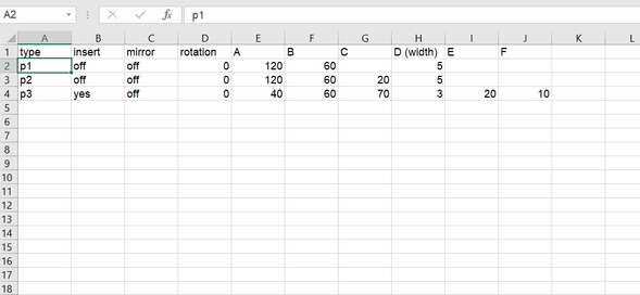

Moshe-A
@archana96  hi,
Attached profiles.zip file contains 2 files:
1. profiles.vlx
2. profiles.csv (data file)
Because there are many properties you have to set at each insert, the idea here is to create an excel file (csv)
serve as profiles library so lets look at the data file format:-
in this example it contains 3 rows each represent a U profile.
The first row is header.
first column 'type' (p1, p2, p3)
second column call 'insert' can have 4 values, switchs on,off or yes,no meaning yes to insert the profile or not.
third column call 'mirror' same 4 values, switchs on,off yes,no meaning yes to apply mirror or not.
forth column call 'rotation' degrees for setting rotation angle.
the rest column A, B, C, D, E, F dimension as specified in your picture.
note:
in third profile you specified 'F' as width but in the first 2 profiles 'D' is the width so i change it 😀
after loading the the lisp key:
Command: PROFILES
pick data file
profile "px" insertion point:  <specify point>
The program read data file in than goes to check cells validation and if invalid data found you will be notify.
than you will get your profile.
you can have many data files (pro1, pro2 ....)
you can add as many rows (records)  as needed [as long their type is 3: p1, p2, p3]
with 'insert' column you control which profile to insert. if two rows (or more) have insert=yes, you will get two profiles.
enjoy
Moshe
Message 8 of 17
Sea-Haven
@Moshe-A a really good idea using excel maybe add size to the types. An extra column
no need for thickness as shapes are defined for thickness by name if need thickness add to name eg ANGLE, has multi thickness for same size.
And so on.
P1 12060
P1 180100
P2 12075
Message 9 of 17
Moshe-A
@Sea-Haven ,
thanks you, lets see what OP has to say
