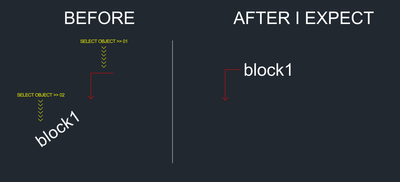

I select leader and mtext the mtext will be move to leader third point
here i attched drawing in what i expect

Kent1Cooper
And would the Leader's tail end always aim to the right like that?  That is, can the Mtext always be placed and justified to extend rightward from the tail end?  I assume not....  If it might sometimes aim to the left, might it also sometimes aim up or down?

jaimuthu
yes the mtext will be placed on tail end its may be any direction left or rightthe mtext will be placed 0 angle
