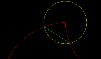

An essential question!  I did some experimenting, wondering whether CHAMFER would even work at all with Polyline arc segments.  It does, but it changes them!  Here, the red ones are the originals, and the yellow the result of CHAMFERing:
I suspect it's keeping the bulge factor of each arc what it was, and the end away from the CHAMFERing where it was.
So if Polyline arc segments are involved, it should not be done by calculating CHAMFER Distances and then applying the command, but by calculating somehow where the chord Line should go, drawing that and TRIMming the Polyline to it.  The big problem would be figuring where the Line should go -- there are infinite solutions:
Presumably one would want the one that takes the same amount of length off each arc segment.  I think that would not be just calculable, but would need a trial and a test, a refinement and another trial, etc., until a solution is within some tolerance.
Kent Cooper, AIA

@Kent1Cooper ,
This would be a simple way (so long as the legs are treated as straight chords, not arc lengths)...
It's as easy as 1, 2, 3 ... the colors, get it?
Oh, wait a minute there, Uhden.  Yes, we start with the red, but then the length of the green comes 2nd.
It IS looking more like trial and error. 😵
John F. Uhden

"Presumably one would want the one that takes the same amount of length off each arc segment.  I think that would not be just calculable"
You can roll up to it with pretty good accuracy. I'm sure someone good at math could do it better than me. here's a proof of concept

I'm not familiar with Python, either, but line 31 and following look like they are doing just what I suspected would be needed -- it's not a direct calculation, but a matter of trying a value, testing the distance between resulting points, and adjusting the value to get closer to the desired distance, until the result falls within the required tolerance.  The same could be done in AutoLisp terms.

... and of course, there are limitless possible configurations with multiple solutions of the same Chamfer-piece length at the same distance down both sides from a vertex.  Just a couple of examples:
in which cases I assume the desired result would be the one closest to the vertex.
But a potential difficulty arises.  Let's say the first-shot attempt in the left image, depending on how it comes up with a first try, lands just to the right of the right-hand yellow line.  The potential Line there will be too short, which in most circumstances would suggest that the next try should be farther from the vertex.  But that will only make the result shorter, and then it will try even farther away, for a result even shorter for a while until the spacing gets to widening again, and in that particular Polyline going all the way to the ends won't reach the desired Line length.  It probably wouldn't be able to know [or it could at least be a coding challenge to get it to realize] that it should try going the other way from the first attempt.
I assume there's no way to account for all possible configurations in a fool-proof way, so there will probably always be situations that a routine can't handle.
