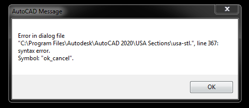

Sorry Guys, I have a second problem. I modified a different steel lisp to the one I have just posted, (which was originally written for USA sections and Australian sections), to accommodate South African steel sections, which is working fine. I have just spent three months in the USA and will probably be going back, so I am trying to get the original USA section lisp to run with different file names as I don't want a conflict with the files I have modified and which are running.
I have re-named the lisp and dim files associated with it, to USA-Stl and edited the name in the lisp to reflect the new name, but it is not running, and I can't find out what I have done wrong,
Please can someone help. I have only attached one dim file from each lisp, but can attach all if necessary.

Thanks for he reply. I was going to comment out that function, but never did it right. When I try and load the lisp,  it gives me " line 367: syntax error " and when I went to that line, I couldn't see what was wrong. That is why I numbered the line.

AutoCAD 2020 I load it from the Ribbon ^C^C_(load "USA-Stl") STL_USA
That is the same way I load the other  Stl lisp ^C^C_(load "stl") STL_RSA which works fine.
It is still not working, see attached error message.

>".. it gives me " line 367: syntax error ""
Please read the message again, the error is located in the DIALOG file (dcl), not in the *.lsp.
And a quick look into the dcl file... yes, that's looks like also your own editing.
See the difference of original "command" sign in dcl file and your(?) sign for comments.

Thank you for your reply, I have corrected the dcl and lsp files, and all is working.
The command works as I had it, so I am not going to change it unless there is a better way.
