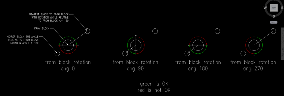

...but I need more option:
1 just to work at certain angles. I need draw a pline between selected block and their nearest block but that is above base point (90 grades). Angle might be a variable.
2 just to work at the selected block of distinct names
3 link selected blocks to one block with a certain name or a layer with a certain name.
...I think those request will help a lot of people.
image explain how I need request 1:

For Your 1st requirement (after looking the attached Image) I did not get your point.........
1   What do you mean by "certain angles" the "PLINE" angle .... connecting the base points of two Block.......?
What do you mean by  "90 grades" ........ difference of Y co-ordinate of two base points.......?
3  What about 180 degree in attached Image....?

 ___________________
thanks for reply your code works great as always.
about the first request. I need to link to nearest blocks but ignoring (marked with red) blocks that are between 180 to 360 grades of the base point (should ignore their base point), no matter their rotation. (like the image)

something like this image (block marked with an "X" is ignored because are between 180 grades and 360 grades respect to basepoint angle 0)

dlanorh
@jtm2020hyo wrote:
Is the 0-180 degrees relative to the rotation angle of the block you are drawing the line from? See attached drawing.
I am not one of the robots you're looking for

@dlanorh wrote:
Yes. In each block angle is relative

dlanorh
OK. Try the attached. It's not tested.

dlanorh
I managed to test and it didn't work for all "FROM" block rotations. I have amended and (minimally) tested, and the attached should now work.

@dlanorh wrote:
yes. your drawing attached explain better what I need.
